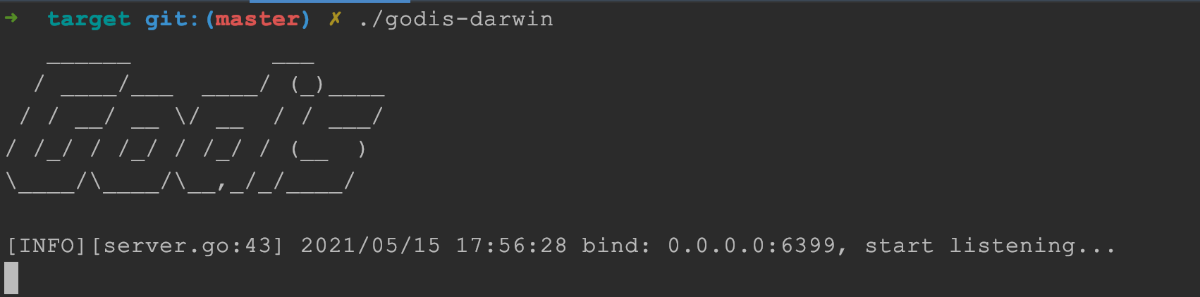

You can get runnable program in the releases of this repository, which supports Linux and Darwin system.
./godis-darwin
./godis-linux
You could use redis-cli or other redis client to connect godis server, which listens on 0.0.0.0:6399 on default mode.
The program will try to read config file path from environment variable CONFIG.
If environment variable is not set, then the program try to read redis.conf in the working directory.
Please see example.conf for all configuration information.

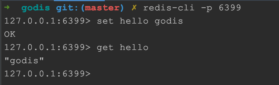

redis-cli -p 6399
Please refer to example.conf for cluster configuration.
